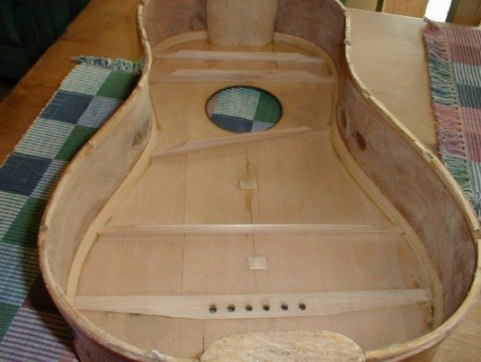

...or you could use a hybrid approach:
... and either shave your X-braces to your heart's content, or re-think the old X-brace paradigm in favor of something that supports sonic production rather than holds the guitar together.

Hi Alan,
Interestingly, after I did this, I saw a patent by Ned Steinberger for a "stress-free bridge" that was a similar concept. Ned exited the holes at the back of the bridge at the same height as the saddle, and had an elevated tailpiece that in effect eliminated the torque. So, my design eliminated shear, and Ned's eliminated shear and torque. A few prototypes were built by Steve Grimes. By the self assessment of Ned Steinberger, and by my own results, I honestly don't think anyone has hit a home run with these concepts yet. However, I do think it has proven some engineering concepts that should enable someone to surpass what can be done with an X-brace, both in terms of timbre and loudness, and in terms of instrument longevity. I don't think anyone should abandon X-braces now, and maybe never, but I do hope that some others with an experimental mindset will keep tinkering with this "tunnel bridge" concept (combined with suspended structural bracing) to really check out what the potential is.
Even "in an 'ecosystem' where there is heavy selective pressure", if 99% of guitarmaking luthiers follow closely the path of C.F. Martin, there will be very few "mutants" or "evolved ones" (matter of perspective) to examine.

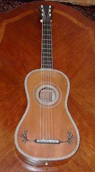

Builders of the early 19th Century - Early Romantic Guitars (Len Verrett site)DennisLeahy39098.6407060185
